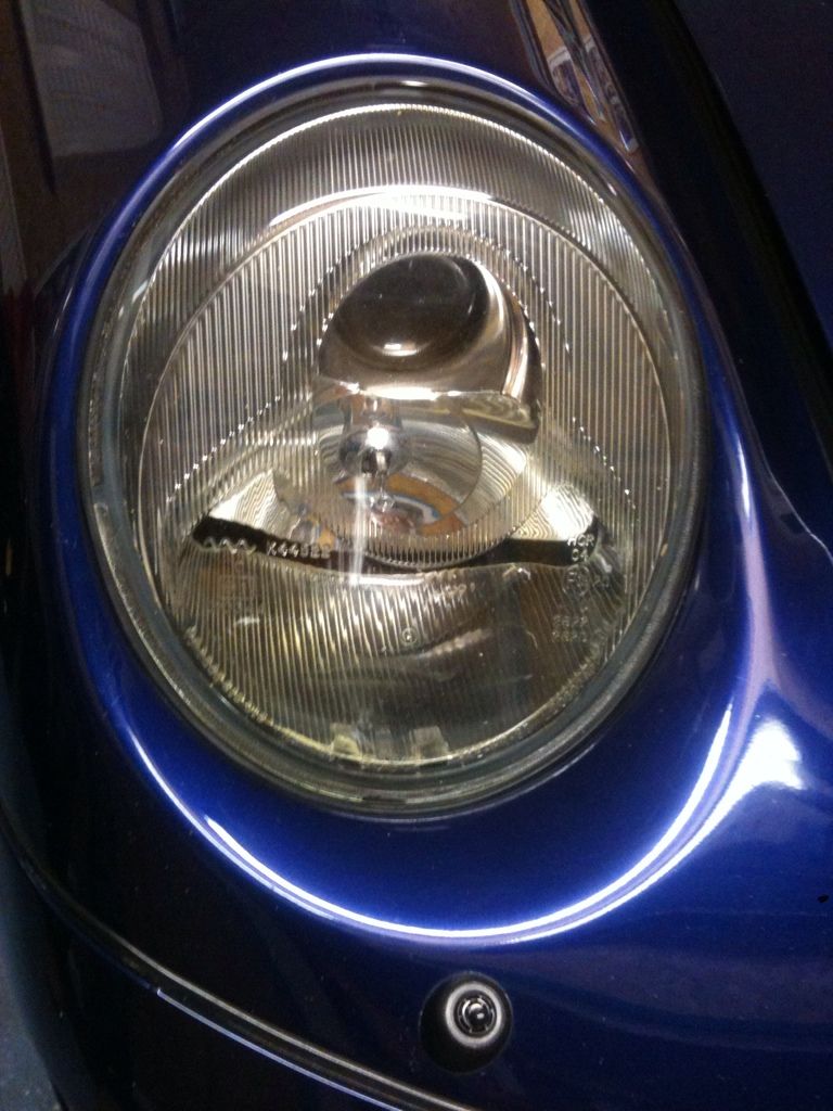

PostPosted: Sun Jan 20, 2013 8:07 pm    Post subject: Reply with quote
Cheers Dom , doesn't look too bad a job..
Here's before and after pics.. Not the same angles , but the car is in the same position with the same light source and same crap iPhone camera.
