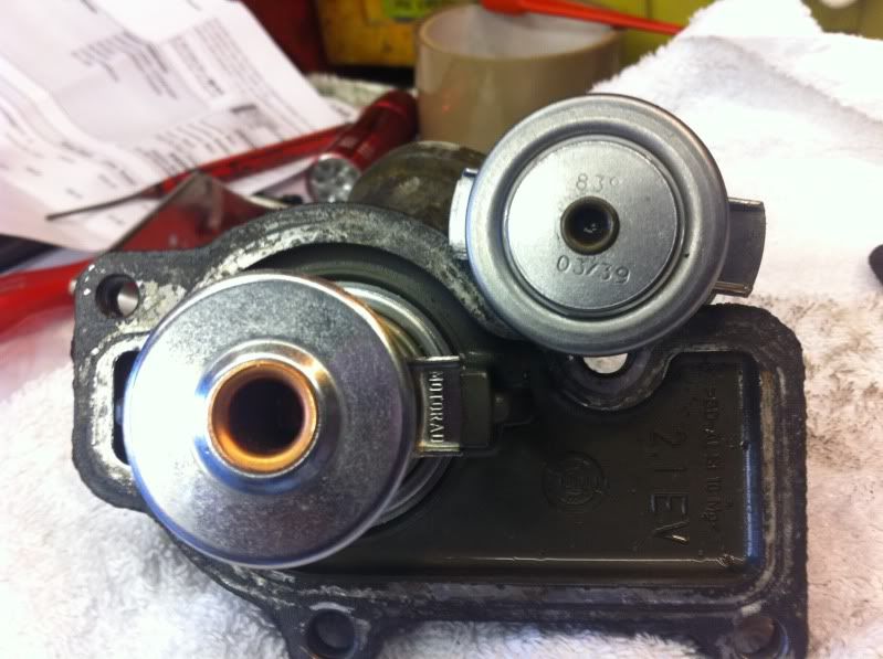

Thanks for putting this guide together, I fitted a low temp thermostat to my car today.
One of the 3 bolts holding the metal pipe to the engine was reluctant to come out to start with and had me a little worried but a good spray with WD40 helped. The top bolt on the housing is a little difficult to get to, used a cranked spanner for that one.
Pic of old vs new taken during test fit, I cleaned up the housing fully before refit:

I'd never run a 996, or in my case a 997(done) without this mod Thumb
I have long had the view that heat management(or lack of) contributes to engine failures on 996/997.
The reason they run hotter as standard is to meet the reduced emission level demands that the eurocrats forced onto Porsche, with regards to the 996/7.
You will see a slight increase in the emission levels come MOT time but they should still be well within the legal requirements. Thumb
I think for the GT and Turbo cars they stuck one finger up to the eurocrats Floor
