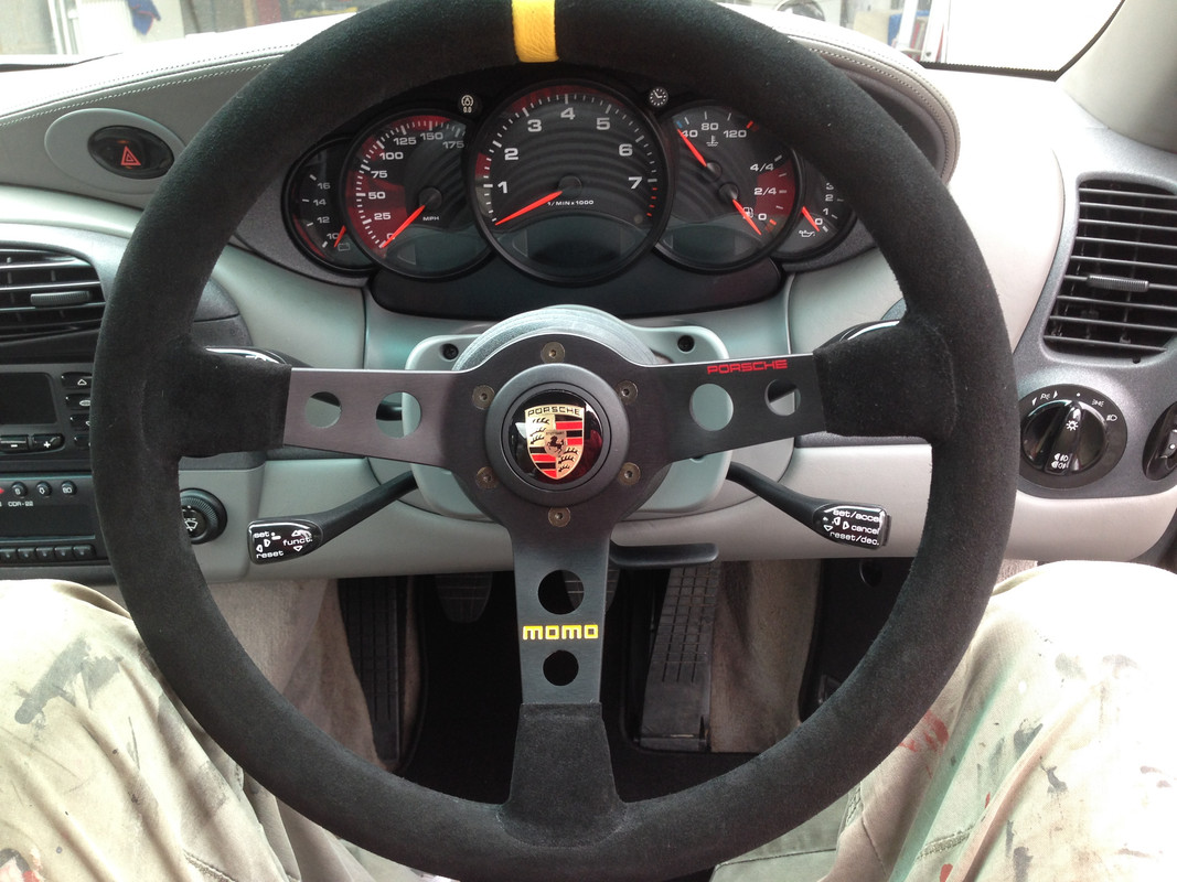

Here's mine in my grey cabin.
That looks superb! I've recovered my own wheel, but id consider changing it for that. What size is it?

Cup wheel is 350mm
