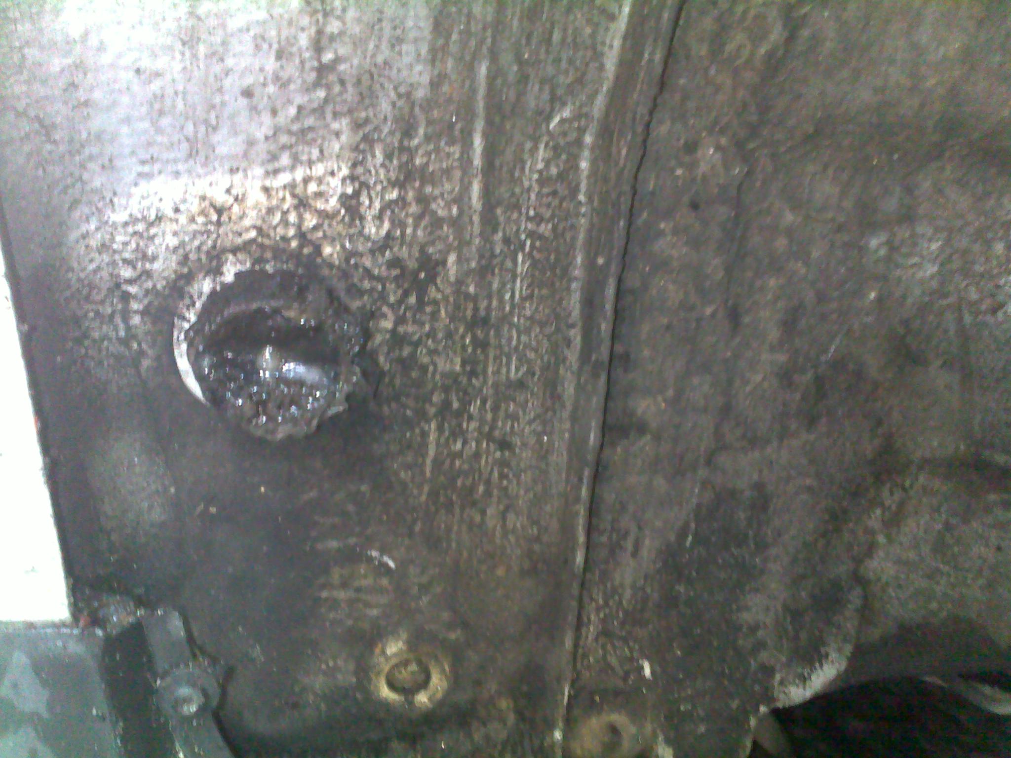

PostPosted: Tue Jan 30, 2018 9:04 am    Post subject: Reply with quote
Remove the front part of the rear wheel liner and you'll see a drain hole.....probably bunged up like this:
wasz
Joined: 28 Dec 2012
Posts: 2864
1999 Porsche 996 Carrera 2
PostPosted: Tue Jan 30, 2018 9:35 am    Post subject: Reply with quote
Take the opportunity to clear out all the mud down there hiding behind the plastic, and check for rot.
