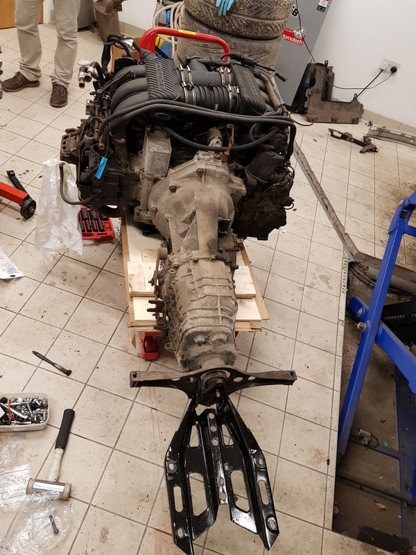

After a couple of hours or so of disconnecting pipes and unbolting things, the engine and gearbox are out.
I haven't bothered to do a blow-by-blow account of this as so much was already removed it would be of no use to anybody else.
MC

I spy with my little eye.....
....an accessible AOS
I would change it out now so you don't have to go through the trauma of an in situ change. Although I suppose you have all the equipment to whip the engine out again quickly in future.
The engine will only be in for a few thousand miles tops before it is pulled for the new one to go in, so I probably won't do anything other than fitting the tappet chest for testing and swapping the manifolds so I can use the new ones.

PostPosted: Thu Feb 07, 2019 9:06 am    Post subject: Reply with quote
Can you post a photo of the side of the gear box so we can see the mount in place please? All the other photos on the www seem to be taken when the box is in the car.
Thanks
Thanks
Is this what you mean?
MC
Thanks
MC
Yes MC - thanks
Alex - I wanted to see it in the frame to put it all in context. But thanks for your photo too.

MisterCorn wrote:
Oh, that is interesting Surprised
MC
Ok - I give up - what can I not see. Is the engine mount frame thing cracked? Also, what is the writing on the casting?
MC
I'll give you a clue, it relates to the scavenge pump.
MC
